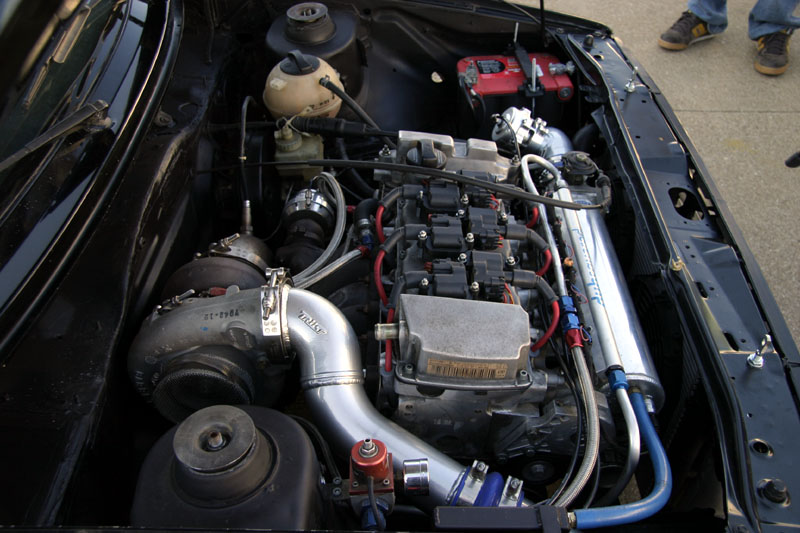

Anyone do this? Apparently they have igniters built in so you can loose the ICM altogether.
1.BillyT from Vortex:
At 19 psi, 24 degrees peak timing, C16 and 93, 9.5:1 CR...
507 wheel, 435pound feet.
Stock head, stock cams, still just running off wastegate spring right now.

NM...just read and learnt it was standalone....should have figured it was a bit much HP with OEM ECU
